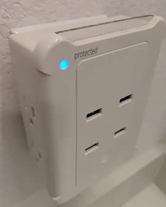

We have a "charging station" that has four USB ports on front and four regular outlets, two on each side, that was plugged into a bathroom outlet.
Front view of outlet

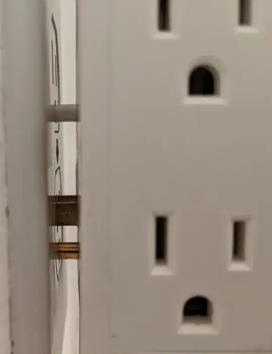

Now I am trying to remove it, but it seems to be stuck. There is enough for a gap at the back to see that it appears to be flexing both the back of the charging unit and part of the outlet, so I am afraid that if I pull harder something is going to break.
Top view of outlet
I have been trying to wiggle it up and down and from side to side in order to coax it out, but it is not working. It appears that the is a plastic "pin" (it's white anyway) that is going into one of the grounding holes and that is what is stuck.

Here is a third picture: it is not a GFCI output (there is no "reset" button on it) and the device is plugged into only the bottom outlet with a plastic pin plugged into the ground of the top, presumably to help stabilize it. side view

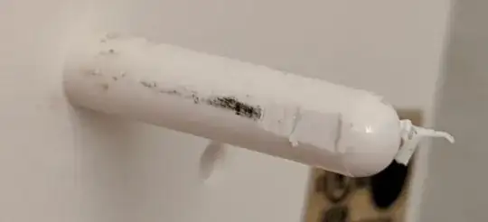

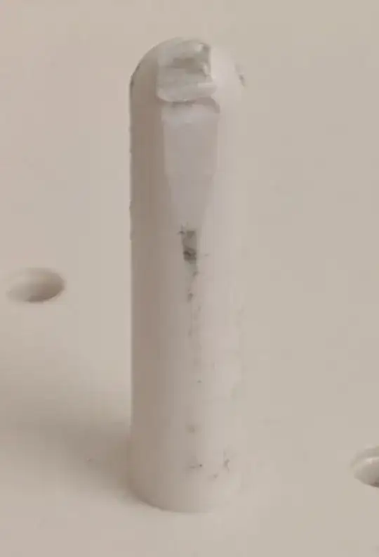

Afterwards, I looked at the plastic pin. It did not appear to be burned or melted, but part of the plastic had been scraped off like it had caught on something in the outlet:
back of pin
front of pin
