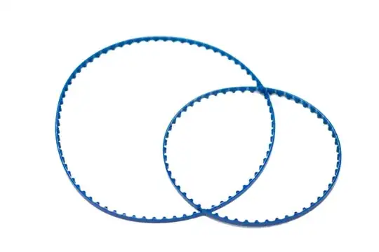

While the slow moving seems to be tied to pressure, one would think, it was not in my case. I finally decided to take the robot apart, and the 2 wheels on one side have 2 separate belts running off a pulley. It turns out, one had broken, therefore passing no power to the back wheel and tail.

I used to be the pool gal at the country club for my dad in summers when I was in high school (don't ask). That belt drive system is really old, <mid 90s maybe? Did replacing the broken belts fix it? If not, or to the other poster who didn't mention belts, off the top of my head, first, check your pool wall fitting for a clog or breakage. If that's OK and the pressure's good (I forget, look it up yourself), I'd suspect a drowned float (the egg-shaped thing on top could be water logged). There are a lot of things that can (and will) go wrong in a Polaris. The tail is never really a problem and the sponge is just a mop attached to the exhaust. There's no need for back pressure, it'll run just fine without the tail as long as the port isn't clogged. You could still have one or more bad wheel bearings (there's three, if the wheel rattles, it's bad). You could have a leaf or some other crud wrapped around the axle stubs or jamming a bearing. You could have a cracked housing allowing the wheels to wiggle. Hard to say without seeing it, start with that. Good luck.
