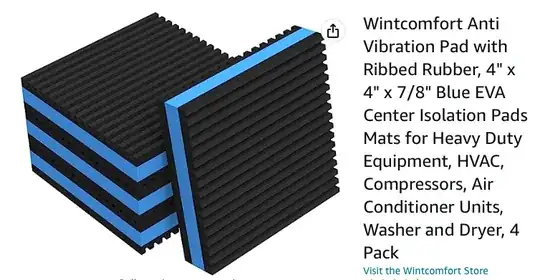

As you have probably seen already, "anti-vibration" pads exists and they are quite pricy and quite small (4in x 4in). The ones for washing machines are designed for durability under mechanical stress (weight & movement), and water resistance. The ones for audio are designed for aesthetics and profits. Your DIY solution will likely be much better, plus you can experiment with it.
