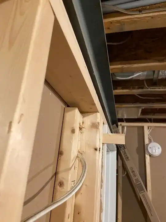

As you can see in the picture there is about a 3/8” offset from my beam to the studs. I would just shim it to cover that gap but the doors are framed for 1/2 drywall and the other side of this wall is finished. Not sure what to do to have a clean wall here. I don’t really want to have a jut out to accommodate the beam.
Any suggestions?

You really just have two choices here. The first is to frame some wood structure over the steel beam that you can then attach drywall to. This does lead to a "jut out" as you called it and it was clear that you did not like this approach but it may overall be easier than the other alternative.
The second approach is to add shim strips to all the studs to bring their surface out enough that drywall can then be mounted straight up to the ceiling. You will still have to do something with some framing in and around the steel beam so that that upper end of the drywall has something to fasten to. It is possible that could just be a strip nailed across the bottoms of the overhead floor joists. With regard to the door it is not uncommon practice to have to install wood strips to this side of the door frame so that the jamb extends out to the surface of the drywall. These are often called "jamb extensions" and quite commonly are custom made to the specifics of the job at hand by ripping strips off a nice pine board using a table saw.
Michael Karas
  • 67,833
  • 68
  • 153
The overall easiest "workaround" is to add firring strips to all the wall studs and top plate. This adds 3/4" and allows the drywall to clear the edge of the beam. A few wads of construction adhesive or even drywall compound between the beam and drywall for a little support and all you have to worry about is screwing into the top plate. ( no other anchoring needed on to the beam) Problem 1 solved.
You will have your drywall 1/4 inch proud of the door jamb. Then you need to make the Jamb extenders as suggested by Michael Karas. Problem 2 solved.
Install your door casing and finish to your preference. Enjoy an adult beverage of your choice.
Done
