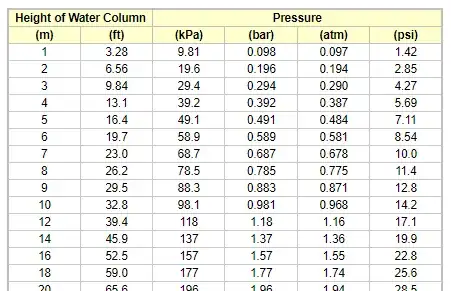

The chart below will go a good ways toward showing what part of the basic problem is here. Consider your uphill pipe as an equivalent of a 35 feet high water column. The chart shows that the pressure of such column, as produced by gravity on the water, at the bottom will be in excess of 14.2 psi. This means that you immediately lose 15 to 16 psi just to overcome the static pressure caused by the water in the pipe.
