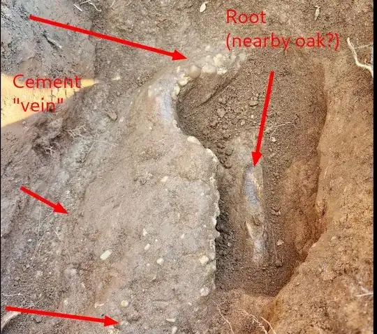

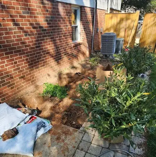

1952 build Maryland house. My wife wants to landscape the area on the south side of our house. We were planning on putting Otto Luyken English Laurel next to the house. Upon digging I notice this irregular, large stone, cementitious "vein" running along the side of the house about 2 feet deep extending (as best I can tell) 2 feet from the house (honestly I don't know if it's attached to the foundation. There is a big oak Tree about 10 ft from this location. I BELIEVE I can get under it, but I'm not 100% sure.
Is this part of the foundation in any way? Would it be safe or recommended (or not) to use a jack hammer or hammer drill to break it up to make more room for the Laurel root system or should we look for an alternative solution?

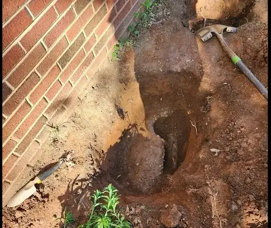

full view one of the holes close up

The concrete is 2 feet deep. It should not cause any issue with the plants you want to put in. Anything needing to be planted 2 feet deep or deeper should not be placed that close to the house.

A "concrete cover" is sometimes used to protect buried utilities below. A few inches of concrete are poured in the trench, over the pipes or conduits, typically for gas or electric. It allows a reduction in burial depth, at least for electric.
As such, attacking it without eliminating that possibility might be ... unwise.
Then again, in Maryland, you might be looking at your footer for that part of the house, if they just poured it in a trench with no forms.
The location seems a bit close to the house for a cultivar described as "dwarf" but also described as growing 6-8 feet wide.
this house is cut into a hill, so on the south side of the house it's ground level and north side it's underground
Could it be a soil erosion prevention
