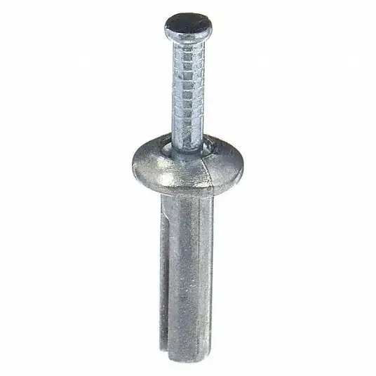

Drive Pin Anchors
aka Hammer Drive Pin Anchor Set
I've never been able to shear them, but must be drilled out to remove.
From https://www.grainger.com/product/11K342

I’ve used these lead anchor drive pins before. They were excellent compared to those tapcon when I was trying to go into cinderblock. What I liked about the hammer based ones was they never loosened up I had them installed with some cabinets that had a flat back and use them to attach the cabinets to the wall Through the wood frame. In the past when I’ve used the tap con into Concrete block, eventually they rushed and the device I had mounted to the wall which just fall to the floor after a few years. I was surprised to see this because they had that blue coating on them, which I thought was supposed to prevent rust .
