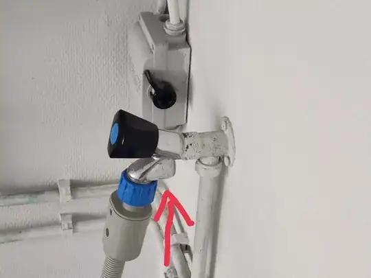

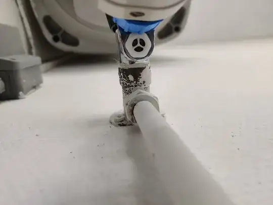

I recently moved to a new house and am in the process of setting up essential appliances. While trying to connect the washing machine, I noticed that the shut off valve is leaking from a white hole(?) underneath. I want to know what the hole exactly is and how I can fix the leakage from it. See attached picture(side view and bottom view) for reference. Thanks in advance :)
Edit: I am from the Netherlands.
Backspace
That part prevents backflow into the water line.
It has flats so it can be unscrewed.
Purchase a replacement where you normally buy hardware or plumbing parts. (take the pics you posted here with you).
Unscrew the old part. Screw on the new, per instructions. Done.
