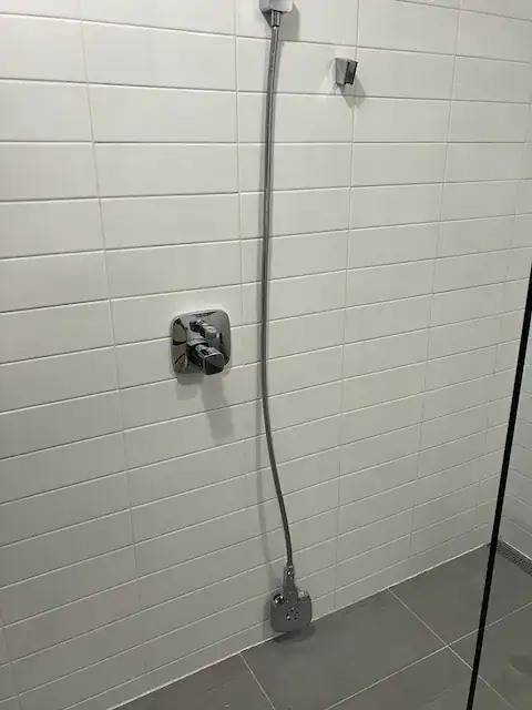

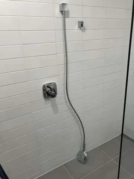

I'd like to shorten a Hansgrohe Techniflex hose. The spot that the pipe nipple comes out of the wall is too low and the handshower can hit the tile.
Here's a pic. I already broke one hand shower this way.
hose too long

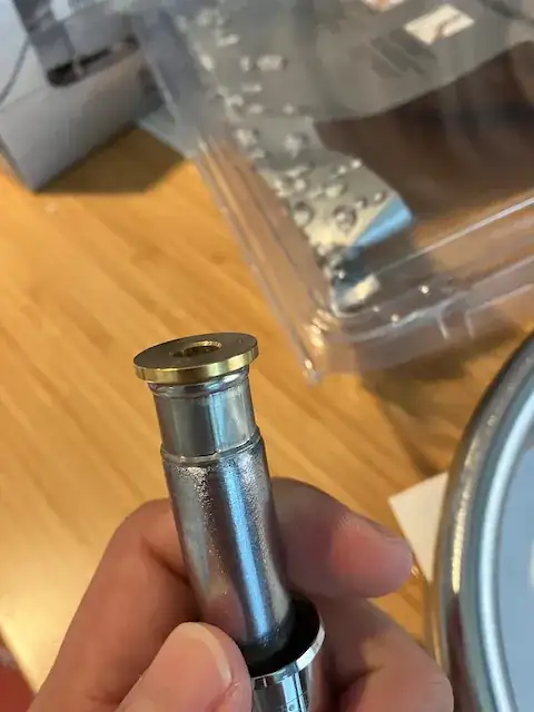

The Techniflex hose is a silver flexible hose that has been great, no kinks, flexible, no uneven surfaces to gunk up.

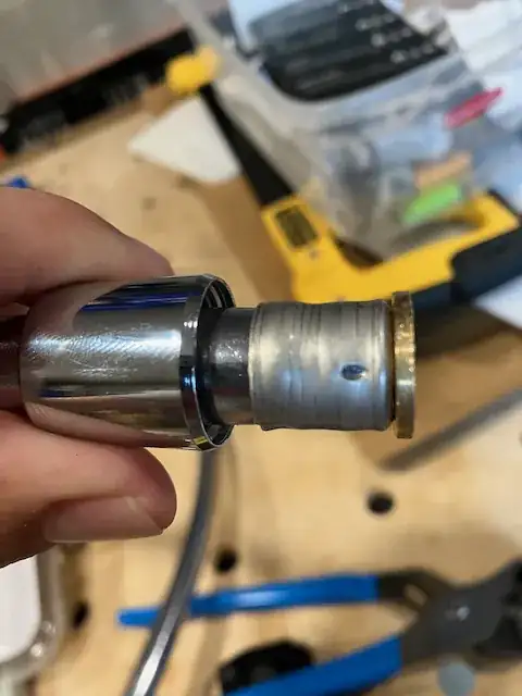

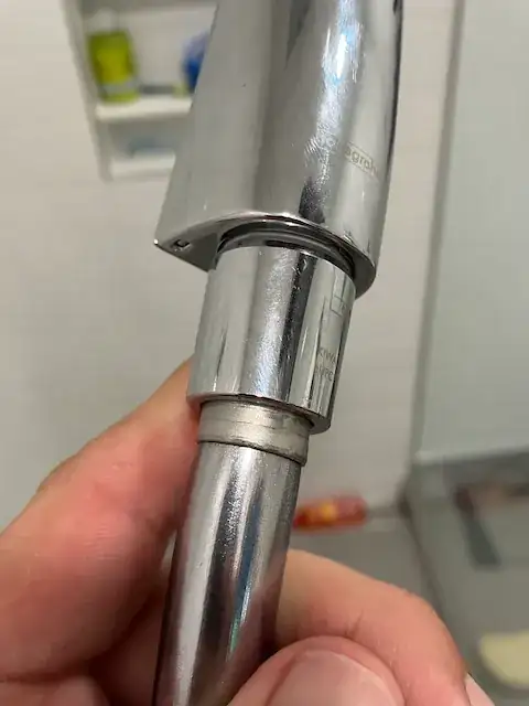

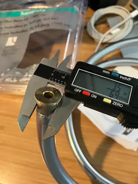

The fitting on the end is shown in the attached pics. It's clearly a brass piece that fits into the cut hose end, with a collar crimped to hold it in place. The od of the hose is a hair under 5/8 inch (I don't know the id). The crimped collar is 35/64 final dimension (aka 0.546 decimal inches).
Anyone recognize this setup? I think I can get the brass insert out by cutting the crimped collar, and I'm wondering whether a PEX crimper could secure it (after cutting the hose). Looks like it is a stainless steel ring.

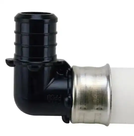

I'm thinking maybe it is a "stainless steel press sleeve" like Viega or Apollo make? I guess this might be the 1/2 nominal size?
Techniflex crimped collar show crimped size
Techniflex crimper collar

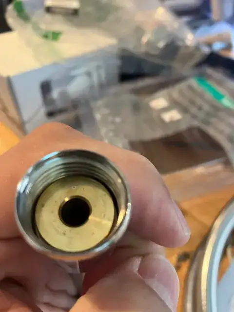

Threaded end

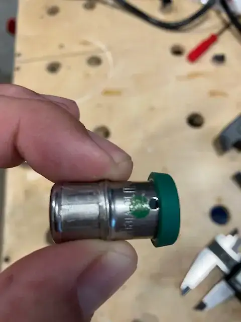

Maybe this:
Apollo sleave crimped

Showing reinstalled handshower now not touching the floor.

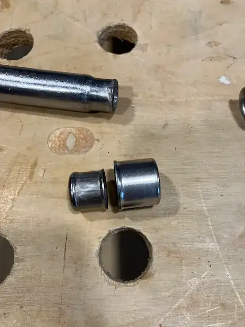

The Apollo sleeve is quite a bit bigger than the factory one.
Apollo 1/2 uncrimped compared with factory sleeve crimped
The factory sleeve is much more like the Viega 3/8 stainless steel sleeve (~14.7mm), the od of the barbed insert is exactly the same as Viega 3/8, so I ordered some of those. But no way the 3/8 viega slips over the OD of the technifex tube (which is way thicker than pex-b), and in any case I could not find a reasonably priced crimper for 3/8 Viega pex crimping.
Uncrimped Viega 3/8 sleeve compared with crimped factory sleeve
FWIW, I also tried the copper rings in the 3/8 size but those also wouldn't slip over the end. I tried compressing the end in a few ways but that was hopeless. Eventually I decided just to try the stainless steel Apollo 1/2" sleeves.
I had to crimp in a few different places down the sleeve, including the flare at the hose end of the crimp, because the female threaded end (chrome) won't fit over that flare otherwise.
Apollo 1/2 primed sleeve with flare flattened
In the end the longer sleeve shows more than the factory one, and there is a little waviness from crimping the flare of the sleeve, but it doesn't look bad.
