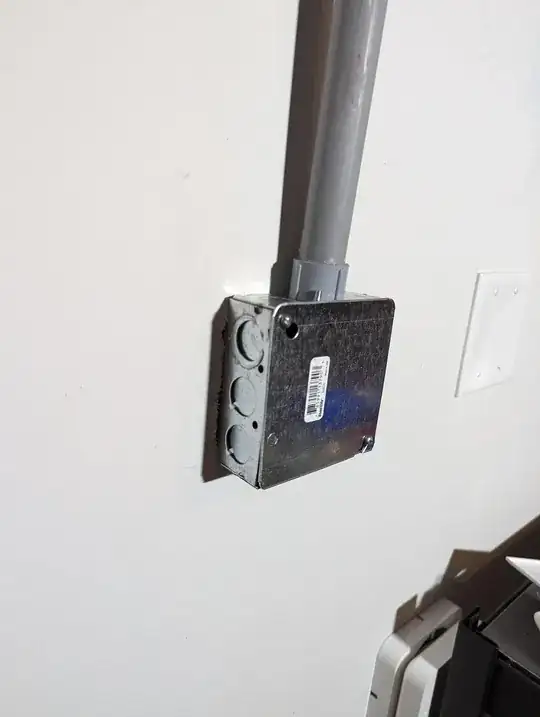

I'm aware of 2 ways to "break out of the wall" from a recessed breaker panel to surface-mount conduit going somewhere else:
  1. In-wall wiring from the panel to a metal box in the same stud bay (e.g. below the panel), then add a metal extension ring on top of the box with a blank cover, and use one of its knockouts for exiting via conduit.

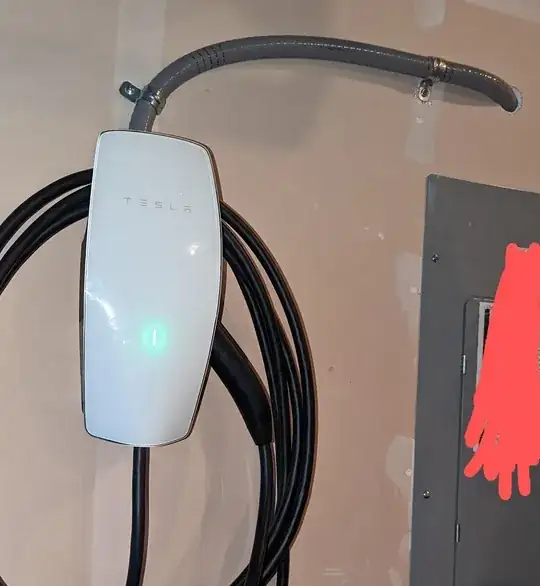

  2. Flexible conduit starting from a knockout at the top of the panel (in-wall), and curving and exiting from a hole above the panel. That hole can then be foamed closed.
Out of these, #1 sounds much cleaner and simpler to me.

There's a neater way to implement the second option
Instead of punching the flex through the drywall directly, what I'd do is a variation on approach 2 that uses a box with a ½" KO faceplate on it at the punch-through point, with whatever in-wall wiring method you want from the box to the panel. You then use a 90° fitting to attach the flex conduit to the KO on the faceplate. Neat and tidy!

#1 is easier and looks better than #2. I'd be using EMT, electric metallic tubing, insteaad of PVC.
#2 is also used extensively but not with the sealtite flexible conduit. Regular flexible metal conduit is used more often and is also cheaper. See picture below from Granger.
