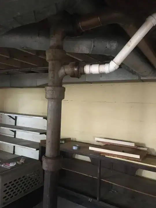

Primary Stack top: Primary stack top

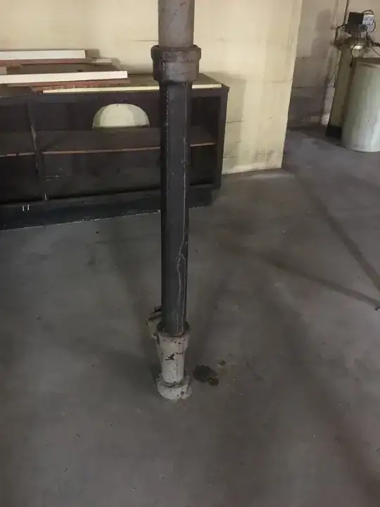

Primary Stack Bottom: Primary stack bottom

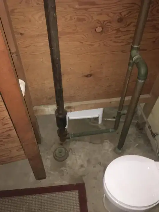

Secondary Stack Top: Secondary Stack Top

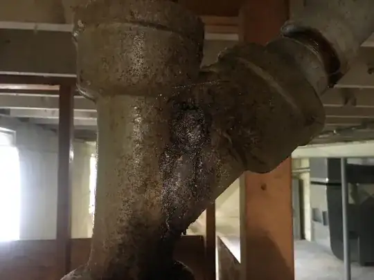

Secondary Stack Potential Barnacle Detail: Secondary stack potential barnacle detail

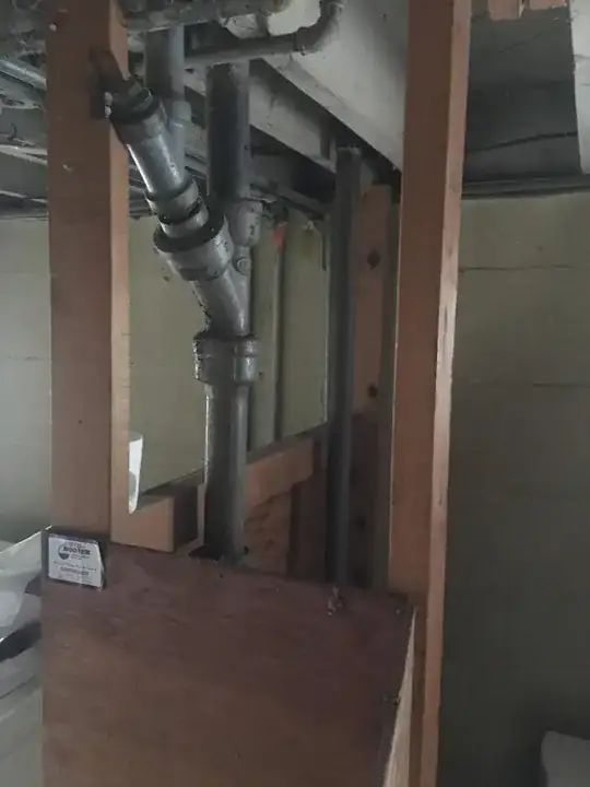

Secondary Stack Top (alternate angle): Secondary Stack Top (alternate angle)

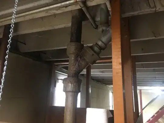

Secondary Stack Bottom: enter image description here

There's no easy answer to "Should I replace my cast iron waste stack?". Their average life span is 80 to 100 years. Yours is 70 ish years old. Some parts of it may fail tomorrow, or the whole thing may last another hundred years.
So you take a gamble.
If you replace the basement portion of it now, and if it would have lasted another hundred years, you've wasted a few thousand bucks.
OTOH, if you leave it alone and it develops a leak in 15 years, it's not a big deal to open the drywall box you've build around it. That's a small extra cost. It looks to be in pretty good shape. So maybe leaving it is the right bet? That's a question not a decision.
OTOOH ... if your squishy bath tub is directly above either of these stacks, and you'll be replacing that tub soon, that changes the equation. If you're opening walls and floors and have access to parts of the stack both above and below a floor .... and that stack is 70 years old ... you're unlikely to have another good opportunity to replace it without doing MAJOR damage to your home, during your lifetime. And yet ... it seems to be in pretty good shape, and you just bought a house, so are you really looking for "best practices" that will suck another 15 grand out of your wallet? Again, that's a question not a decision.
