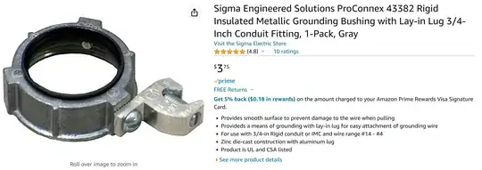

I was introduced to grounding bushings in this answer to a previous question of mine, but couldn't actually find them anywhere for weeks. Finally I bought this one off Amazon, and it arrived this week!
When I tried to use it in a Tesla charger today, I realized how huge this was. It was too big to rotate inside the plastic box, and even if I rotated the EMT's terminal fitting from outside instead, I found it's still too big for the box to close on it.
Maybe(?) I could have fit it inside an extra-deep square metal box, but at that point why would I even need this? It's only useful for plastic boxes, but it seemed too big to be practical there.
Also, size aside, the product packaging only talks about use with Rigid or IMC (but I couldn't find EMT anywhere). I'm not sure if EMT is just not advertised (like other fittings, e.g. straps or plastic bushings) or if this particular one just doesn't work with EMT (if so, where can I find a 3/4" bushing that does?). I wasn't able to find its UL listing to confirm how it was tested.
Is this the right part? Am I using it wrong?

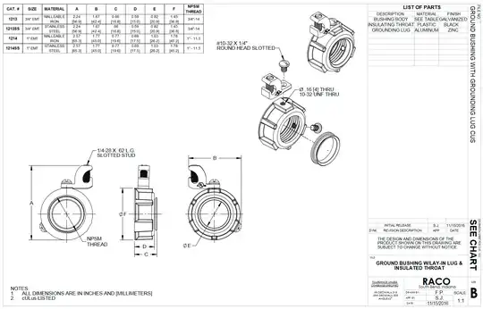

Sample grounding bushing specs (note straight threading): enter image description here
