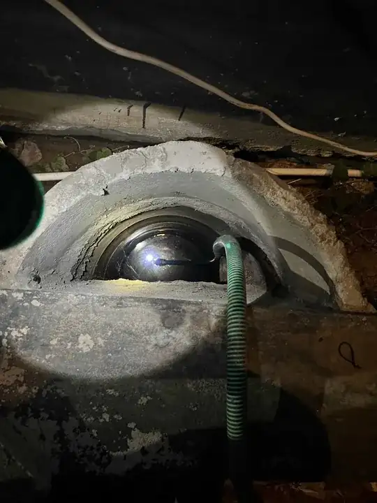

Please find the photo of rain water harvesting pit. It's 2 feet circular cement ring well with open bottom

To solve insects, screening to exclude insects.
To solve "stagnation" either an aerator or a pump so it's not stagnant.
Throw in some mosquito dunks periodically, as necessary.
