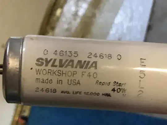

I am trying to replace the burnt out fluorescent bulbs in my basement with compatible LED lights, but I'm having trouble finding a type that works.
These are the bulbs I'm replacing: sylvania workshop f40 24618 e5l2

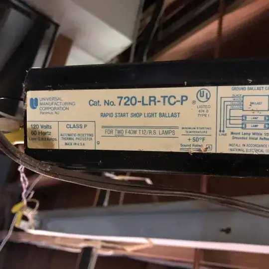

This is the ballast: Universal Manufacturing Corp. Cat. No. 720-LR-TC-P
I'd really rather not have to rewire or replace all the fixtures in my basement, but I've had zero luck finding an LED replacement bulb that works. Any help is greatly appreciated.
Wait. Have you been trying different plug-and-play or universal LED replacements, and they haven't been working???
If you try a "direct-wire" LED yeah, they're not going to work... but if you've been trying P&P or universals, those should work - and if they don't work, the problem might not be the fluorescent tubes. It may be the ballast.
I say that because the tube doesn't look burned out.
I would try swapping with other fixtures. If it proves to be the ballast, then your wish "to not re-wire" isn't going to happen. You'll either be installing a new ballast, or wiring the fixture for ballast-bypass and using direct-wire LEDs. But that's not hard: all yellows to white, and all red/blue to black. Blue wire nut for the yellows and orange wire nut for the red/blue/black. Mind you, that's for that particular rapid-start ballast; other fixtures vary.
