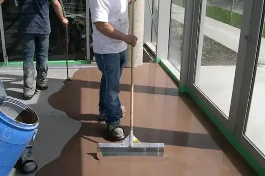

Check the manufacturer's specs on the thinset you are using (or just call their tech support to verify).
Generally, if the variation in the floor is 1/4" or more then using your thinset mortar is usually not recommended for fixing it.
Even though you say it is 3/16", in my opinion, it would make life easier to just use an SLC
