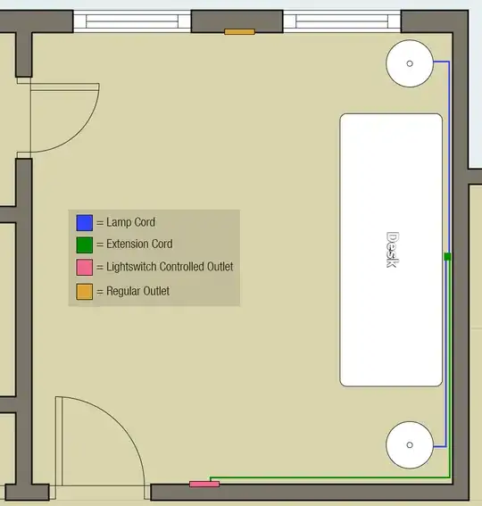

Right now that only way I can see doing this is to have a long extension cord from that outlet that reaches to a point where I can plug both lamps into it, like this:
Room  - extension cord layout
This can work, but it will be kind of ugly with the cables everywhere.

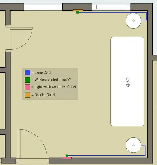

Instead is there some kind of device that exists that I can plug into the light switch controlled outlet that will wirelessly toggle a linked device on an always-on outlet?
I suppose it might be similar to those WiFi things you can plug lamps into, but instead of WiFi it just gets it's signal to turn on/off from the device plugged into the other outlet. Does that make sense? Here's the setup I'd envision for this:
Room - wireless layout
