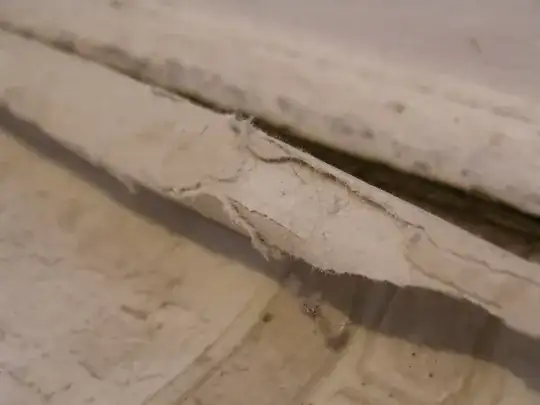

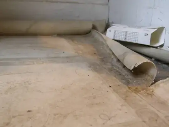

The linoleum floor in my kitchen was installed extremely poorly (long before I started renting the apartment). Many of the edges are curling and in some places, it was not cut to the correct size and they just left the excess curled over. I am concerned that the exposed backing has asbestos in it and was wondering if there is a way that I could seal the exposed backing? I am only going to live there for one more year and I suspect that if I go to the landlord, he will have the floor replaced without taking proper safety measures.
EDIT: Here are some pictures of the floor edges enter image description here enter image description here

This doesn't make sense. First if the floor was installed poorly long before you arrived then it wouldn't last that long - maybe 10 years. Asbestos was phased out of tiles in the early 80s. So is your kitchen tile 30+ years old? I cannot see this from a rental property. Now what is under your vinyl, who knows?
Also you mentioned that the vinyl is curling on the edges because of bad install. I have personally seen many forms of asbestos tile and they are all very rigid. They would not curl up like today's cheap tile sheets. So that is strike two.
Talk to your landlord and ask when it was installed. If it was 30 years ago or he doesn't know or if you don't trust him then get a DIY kit. Cut off a sample and send it in. If it has asbestos landlord has to pay for kit and removal in all states. In some states he would get heavily fined and you could be issued settlement damages. Again from what you are describing I personally do not think you have asbestos flooring.

Don't try to fix this yourself. If it isn't asbestos, why bother. If it is asbestos, trying to fix it yourself could make you liable for any damage you cause by futzing with it. Imagine your pain if the landlord charged you for asbestos removal because you "disturbed" it and created an unsafe situation. And since you don't own the property, you probably aren't covered under those EPA exceptions that apply to homeowners and let them do things like take down popcorn ceilings and such.

Just from the pattern of the floor, that is not from the mid 80's or earlier (when Asbestos was used). My guess, that floor is only about 10 years old as that pattern has an early 2000's vibe to it.

I would glue down the lifting edges, then take a caulking gun to seal the edges.

Asbestos is only dangerous when is disturbed to where it can be breathed in. If it is asbestos and even if it is in plain sight, if you are careful not to touch it, cut it, or crush it then none of the asbestos particles will be airborne and it will not harm you.
I don't recommend sealing it yourself regardless. Dealing with asbestos in any way can not and should not ever be in the domain of DIY. If you feel it has the potential of being disturbed and may be asbestos then I highly encourage you to talk to your landlord and convince him to deal with it in a safe manner.

From the look of your floor, it looks like you need a new floor for hygiene purposes. Asbestos is dangerous because the crystals are extremely long and sharp and penetrate the cells that normally clean dirt from the lungs. The asbestos that would be coming from the area shown would be in pieces not the fine particles that are inhaled and cause illness.
Asbestos is not a toxin or poison, it is the physical structure that is dangerous. Inhaling fine particles is a problem. If you are forced to keep the floor, then any sealant that encapsulates the part that you are worried about will safeguard you.
When the Liberty Ships (Inexpensive cargo ships built during WWII) were built, the construction crews worked in areas that were being insulated with asbestos fiber. The particles were so thick in in the air that some cases it looked like a dust storm. The workers did not use masks and inhaled quantities of the fibers which caused the mesotheliomas and lung cancer years late.
There were enough cases of illness that attorneys put together a class action suit that stirred up tremendous hysteria. Of cause, it's dangerous to inhale the crystals. Auto Brake mechanics were at risk because of inhalation of the asbestos in brake linings.
In general, if it isn't inhaled, it isn't likely to be dangerous. So, as I said have the floor replaced or seal the areas which are friable. Once sealed, it is harmless.
