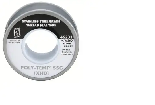

Stainless steel is a harder metal than brass. The pro is that it's hardness makes it more corrosion resistant and durable. The con is that it doesn't give like brass when tightening threads. I found some info on the Boshart and TerryLove blogs. I'm still working on setting up my water system, but saved this picture of stainless steel grade teflon tape. So far I'm thinking people are using a sealant compound and teflon tape and something for anti-seize protection. enter image description here
