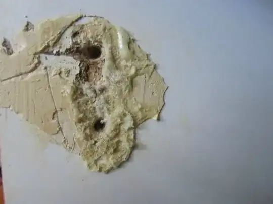

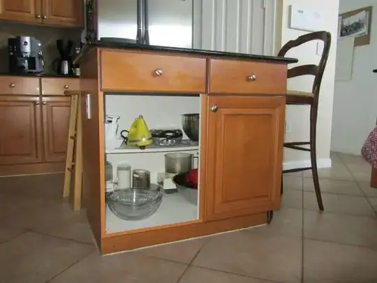

My cabinet door became damaged as my sister put all her weight on it to pull herself up :-)

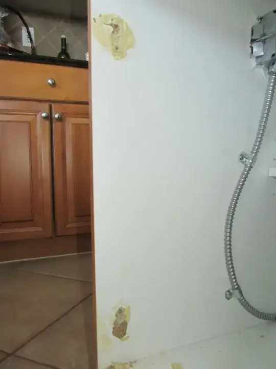

Repairing the door is very tricky as these cabinet doors are on the kitchen island and the particle board panels they attach to are very thin (only 6/8 of an inch thick) and in addition, any repair on the outside part will ruin the look of the island. The hinges on the door side are in good order, and the paneling that needs repair is the one on the island piece.
Our handy man attempted a repair putting epoxy glue or something like that and this lasted only a year and has fallen apart once more (pictures show the white glue-like substance attached to the paneling and the hinges).
Any help would be greatly appreciated. Would the technique of toothpicks and carpenter glue work on cabinetry that isn't real wood but particle board?

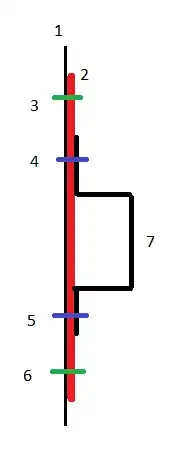

Now suppose that it doesn't work because the particle panel has incurred much damage and you can't repeat the original assembly. So the solution is to attach the hinges in slightly different way. Here's a drawing for a single hinge (description follows)
Here 1 is the inner surface of the cabinet, 7 is your hinge - the hinge will go unchanged.
2 is a steel plate - you can get those in a local hardware store, they are typically used to connect the drywall framing parts together, they are typically 2-3 millimeters thick and can have a variety of sizes, you need something like 50 by 50 millimeters or larger so that it fully covers the damaged area and you can drive wood screws 3 and 6 into the cabinet panel to reliably secure the plate. I only show two screws here, but you'd better drive four - one near each corner of the plate - or more.
Then come 4 and 5. Each of them is a plain old threaded screw or bolt in pair with a matching nut. You'll have to pass them through the holes in the hinge that were previously used to attach the hinge (to now wrecked panel) and through holes drilled in the plate and drive a nut from the cabinet surface side. The nuts will likely fit into the holes of the panel, otherwise you'll have to cut some for them.
If the door now closes - great, that was the easy scenario. However you may find that because the plate has some width the door will no longer close. If adjusting the adjustment screws on the hinge (of both doors) doesn't help fix that you'll have to mortise the plate into the panel to compensate for the plate thickness which is not an easy thing to do but can be done using a router (most recommended), a chisel (less recommended, still doable), or a Dremel-like tool (not really recommended).
