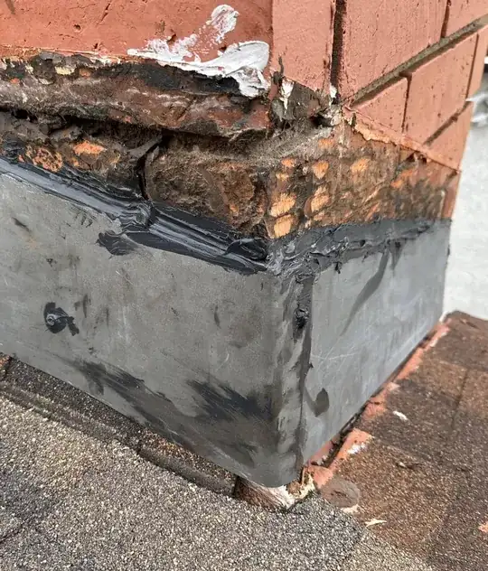

What's the best method for removing dried tar and caulking from brick and getting the brick's surface flat again?
I have a rotary polisher and thought maybe a disc of some kind would work.

Get a chisel and scrape the bulk of the material off the bricks. then get a portable grinder to finish off the smoothing process. You can usually rent them at your home store if you don't have one. I doubt you will be able to safely mount a grinding disk to your rotary polisher.
