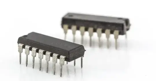

This might not work for everyone, but I have quite a big stock of old ICs laying around that are of no use to anyone anymore.
I lay them down on their back (with the leads upwards), paint one side of the object and lay it down on that side so that I can paint the other sides.
Because the leads are so small, the marks they leave behind are minimal. For most purposes this is okay. In your example: you could place the side with the tiny marks towards the wall.
Note that the bigger (and heavier) the object, the more of these ICs you will need.
