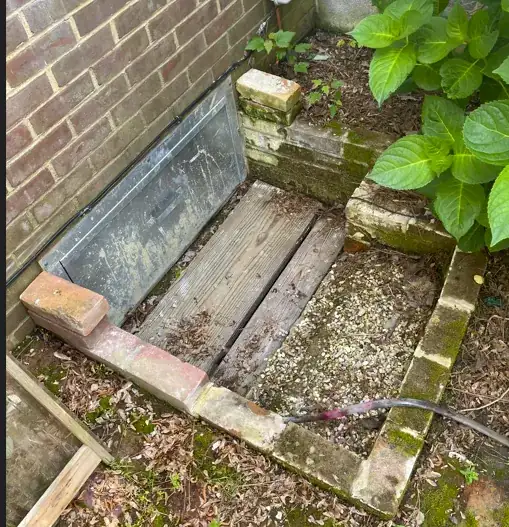

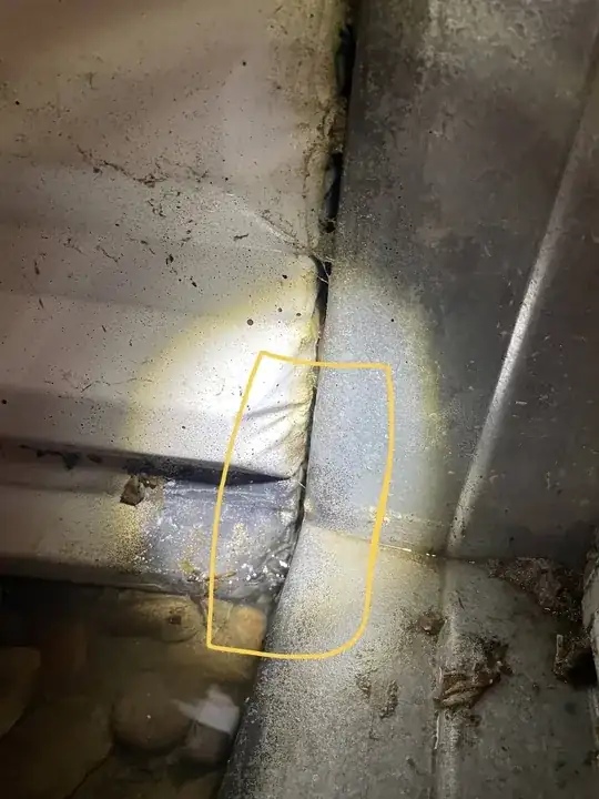

My window well has been filling with water - the base takes about 15 mins to fill before I have to empty with the manual pump - not very efficient especially at 3am. I’m in CO and we have had days of nonstop rain.
The top of the well slopes out and I have 2 tarps over the well. But the water still runs in at the base of the well where it meets the house. The top is dry. The drains are flowing. The basement sump pump is running. I’ve checked all the gutters and drainage pipes, but all seems to be clear. I don't know where else to look. I have looked for a drain pipe but can't find one. Seems these houses don't have one, so will continue to manually drain it.
What should I do? I have thought of using a good sealer to fill the gaps between the well and the home but won't know until it rains again.
Welcome to ideas on next steps.

Sealing the well wall where it meets the house probably won't help much. I think the water in the ground is finding it's way under the window well barrier (by virtue of hydrostatic pressure) and moving up into the open area, to try and equalize the pressure of the water columns on both sides of the barrier.
The only way to really fix the problem (that is, prevent the well from filling with water) is to relieve the water pressure in the ground. This may involve some trenching, French drain (or similar) installation, to drain the ground water away from the house. This would need to be routed down slope (if possible) or maybe into a dry well.

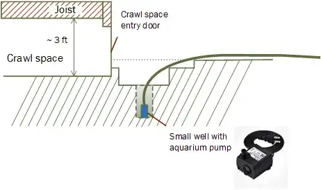

I have a similar situation with an entrance to my crawl space. It fills with water even after the rain has stopped, sometimes for a day or two, depending on the amount of rain
So I did something similar to what you did, but I used a small ~$15 aquarium pump, dug out the well a bit (to create a sort of dry well), set the aquarium pump in the bottom ,and filled with some drainage rock.
The aquarium pump is 115 VAC unit. I have it plugged into a smart plug that I can control from a cell phone app. This is nice when I'm away from the house but still want to run the pump for a minute or two.
Edit 1
Next on my radar screen is to marry the smart outlet with a smart water sensor that will turn the pump on and off automatically. Nice part about this is you don't need very much water for the sensor to work, as opposed to what you would need for a float type switch.
Edit 2 May 2024
One year later I have some observations to share, as to where the water is coming from. After rain has stopped, I can pump the well empty. A day later, there is water in the well that I again pump out. Two days after that, I repeat the process. Note that over the 3 or 4 days mentioned there has been no new rain. The water showing up in the well is migrating through the ground to the well.
