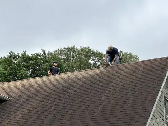

Result:
summarizing the advice here, I had a couple guys come and slice the roof open:
Dead easy.
I'l report in a few weeks on whether it drops the temperature!!
The temperature drop is ALMOST UNBELIEVABLE.
I can't think of anything, at all, in any field, I have ever personally seen that has been so effective. It's mind-boggling.
On a given extremely hot day of a specific temperature, when it would be impossible to get our second story below 85 degrees, I can now get it to 73-74 easily.
Whereas during summer months (indeed until the DAY BEFORE the miracle ridge vent installation) the second story was almost never below about 80, I can now keep it at 71 or 72 as desired all the time.
The difference is almost unbelievable, flabbergasting.
The men in the pic installed a ridge vent on every possible part of the roof, all wings long and short of the structure. It may depend on your region etc but the difference is nothing short of astounding.
