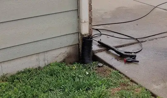

I noticed a few weeks ago during the rainy season that underground drainage from my downspout was flooded and not draining right. I purchased a pressure washer attachment that promised to unclog things like this and went to town.

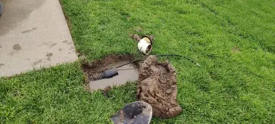

I could hear it underground and after being stuck at the same distance for a while I decided to start digging at that spot. I found a elbow pointing up and a green attachment. My guess is it's supposed to be above ground, and just got buried from years of neglect; I didn't know it and have owned the house for several years.

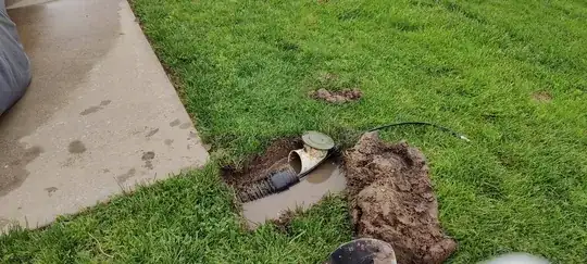

What is the correct way to reinstall this so it drains properly?
Running a pressure washer attachment through the drain:
After about 20 minutes of trying to snake it around a corner I decided to dig and found this:
The device attached the PVC elbow appears to pop up as needed:

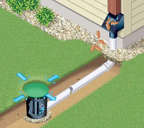

RMDman is spot on, but there's a critical component missing in your system which may have contributed to the problem: A debris filter grate.
You'll notice that most diagrams for this sort of thing show something between the downspout and the underground pipe intended to slough off debris. Any larger debris that enters the pipe is likely to catch on the corrugations of your flex pipe or settle to the bottom, or it may snag on the smaller popup opening.

The green part is supposed to be flush with the bottom of the blades of grass. This so the lawn can be mowed without having to go around the drain.
The center of the drain is pushed up by water. There is no spring or other device. It is strictly a passive process that relies on the rain water building up behind it enough to push the center up and allow the water out of the drain line. Because of this design, the device needs to be installed far enough away and lower than the grade at the house to allow gravity to work and water to flow away through the drain line terminating at the "pop-up".
Obviously, the termination point needs to be lower than at the home so the water doesn't flow back toward the house. Because of this and other factors, (such as amount of rain collected in the gutter serviced by the down spout) sometimes the corrugated piping does not work well and solid drain piping is needed run to the pop-up.
Now a simple thing became complicated, but once set up correctly, it will move water away from the home very well. Good Luck
