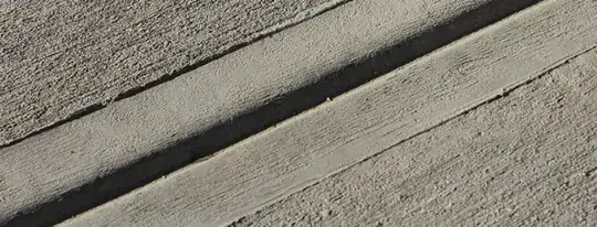

You want to form the sections separately by running a board across at the point where you'll stop the section. The form board at that point can be shorter in height than the perimeter form so that rebar and extra concrete can pass underneath. It's just needed so you can tool the edge to form the first half of a control joint. This can be done on the fly when you determine how far the first batch goes. Just make sure it's square.
You could accomplish the same thing by holding a straightedge over the forms and running your edger along that, but screwing a board between forms is easy enough and provides more stability.
At the next session you'd remove that intermediate form and continue the pour, once again tooling the control joint, but on the new side.
This leaves you with a standard sidewalk control joint, making your work appear continuous.
