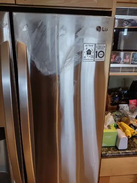

Ok people, I really screwed up. We recently bought a floor display fridge from Lowes. Because it was a floor display it didn't come with a box. Delivery staff taped the doors with packaging tape, which was nearly impossible to remove completely. I didn't want to use any sharp object for obvious reasons. I thought I could maybe get the remaining tape off by softening it with some acetone, because I thought stainless steel is pretty impervious. Well it turned out that it had some sort of finish on it that prevents finger prints. The acetone dissolved it and now I have a bunch of streaks on a brand new fridge.
Question is: Is there a way to repair this? What is the process. Or do we just cover it with children's artwork?
PIC OF FRIDGE

For future reference, start with things milder than acetone, when whipping out the solvents.
I suspect you might be able to take something like white or gray scotchbrite pads (finer abrasive than the green ones) to it and polish it back to bare "brushed" metal, but unless you do the whole thing that probably will look different form the "no-fingerprint" coated sections. And, I suppose, take fingerprints.
