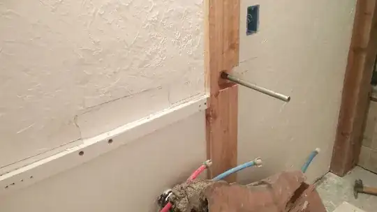

This is the trick I did. I used 2 round hardened steel bars that measured 5/8" (~16mm) diameter and 18" long to hold the counter top. I had a framed wall so I opened up the wall and put 2 2x4's with a piece of 1/2" OSB sandwiched between them into the wall where each of the steel bars was going to be installed. I closed up the opening and measured up the standard 36" and marked the wall with a horizontal line. That line is where the top of the counter will be. I then went into the room behind it and measure up the same amount on the wall where the counter was going to be mounted and drew another line. I measured down 2" from that line and marked the wall in the 2 locations where the 2x4's I added were located.

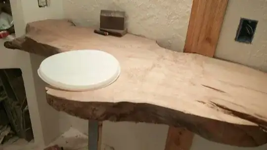

I then got the counter top set into position against the wall bracing it with 2x4's and I also placed 2x4's from the edge of the counter to the wall opposite the counter. You will understand why I did this in a minute.
I went back into the other room and using a 5/8" wire pulling drill bit (really long drill bit) I drilled 2 holes through the wall and into the back edge of the counter top. I marked the drill bit at 19" before drilling the holes so I knew how deep I was going in. Then using a 3lb hand sledge hammer I hammered the steel rods into the wall and into the back of the counter top. It was hard hammering the thing in, I should have rubbed some Ivory bar soap on the rod so it would have gone in easier.
Concrete I would drill the holes a little bit smaller to start off with and see if the bar goes through the holes in the concrete. You want a snug fit so the bar doesn't wiggle at all. You will want to use Ivory soap to get the bar into the wood. You will have to drill with a smaller bit first then take the counter off and go back down the holes in the counter with a 5/8" bit and put the counter back into position.
Using any kind of a screw is not going to work, it will simply tear out of the concrete if any weight gets placed onto the counter. Using steel that is hardened means you would have to put a monster amount of weight on the counter before they would bend. It would be very hard to pull the bars out of the wall because when they are being hammered in the end of the bar is going to mushroom making the end larger than the hole you drilled. You might have to cut the end of the bar off to make it flush with the wall then grind it down a little to be able to patch over the ends.
test fitting the counter
checking steel bar length in wall

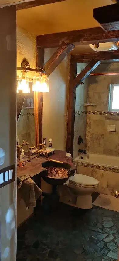

all finished
