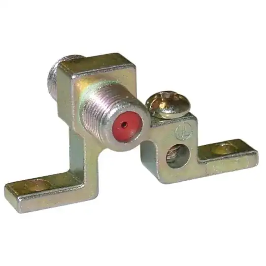

Install a high quality surge protector on every cable which enters the cabinet. That includes twisted pair cable like the ones used for wired Ethernet and coaxial cable if that is used for cable television. With Coaxial cable it is important to use Surge protectors and not just cable shield bonding blocks. Coaxial cable shield bonding connection
You must use a coaxial cable protector instead! Coaxial protector
The protector provides voltage difference limiting while the shield bond connection only keeps the exterior protective braid near ground potential.

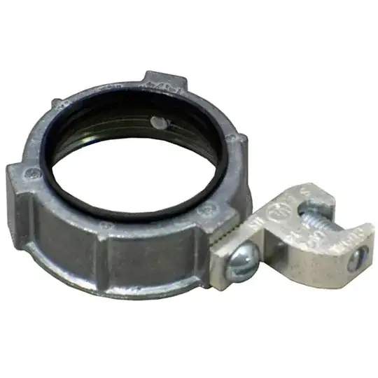

Let me suggest that you run the # 10 green inside the Electrical Metallic Tubing back to the panel and bond it to the EMT at both ends.
1/2" bonding bushingThat will minimize the impedance of the EMT while providing a redundant Equipment Grounding Conductor for the branch circuit. It needn't be larger than the #14 EGC required for a 15 ampere circuit or the 12 AWG for a 20 ampere branch circuit. Notice the Lay In Lug. Turn that straight out from the inside wall of the enclosure. Let the locknut that is on the EMT connector do it's job of holding the connector in place and bonding the connector to the wall of the enclosure by making it up wrench tight. screw the bonding bushing down as far as it will go and then turn it so that you can use both the lug terminating screw and the bonding screw of the bushing easily. The tighten the bonding screw which will make a good electrical connection. Lay the EGC in the lug and tighten the lug terminal screw.
