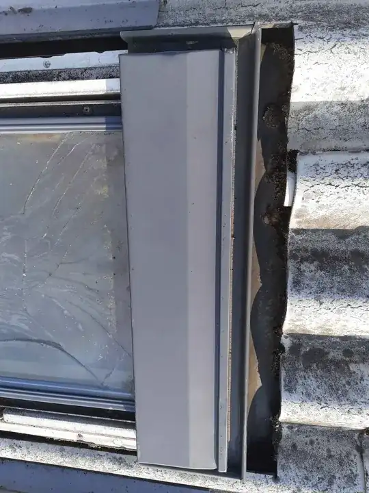

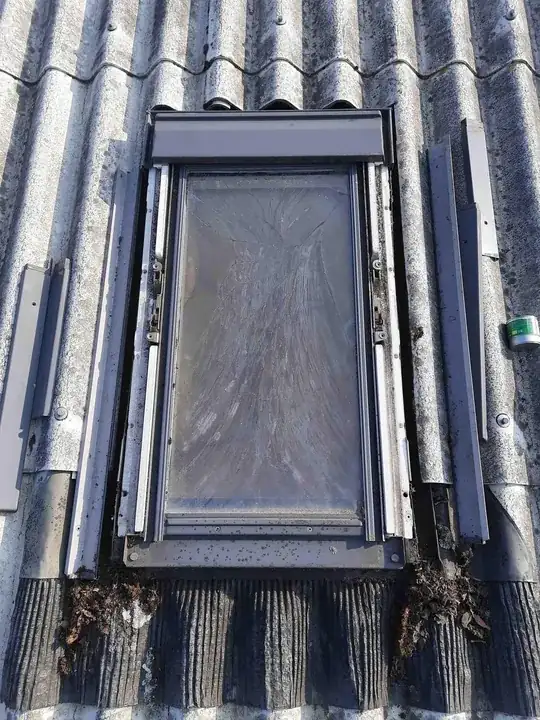

I am trying to remove the screwed panels around the glass. I am not sure how to remove the top rectangular part, I can not get to the top two screws without removing it.
The metal sheet around the window has been bent around this rectangular. I can possibly pry it open and bend it back, but is there a cleaner way or technique to get this done?
Whole window The rectangular part Metal cladding marked in red
