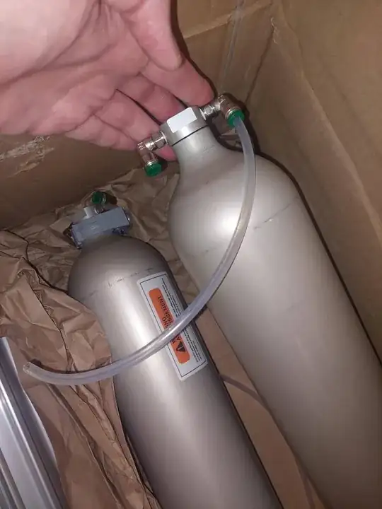

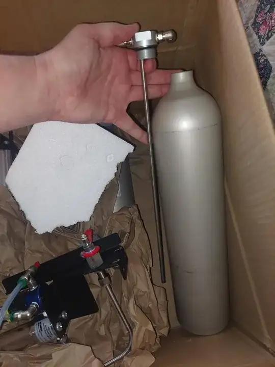

Edit: Adding a few photos of the tanks. These components came out of a Parker CN-6NA (which is very similar to a DN-6NA). Here's the tanks as they were when they arrived in the mail (with the fittings installed): enter image description here enter image description here

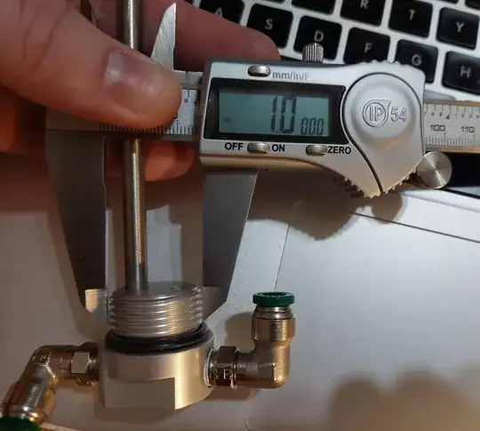

Measuring the threads on the attachment. They're fine parallel threads, 1" in diameter. enter image description here
More photos here.
