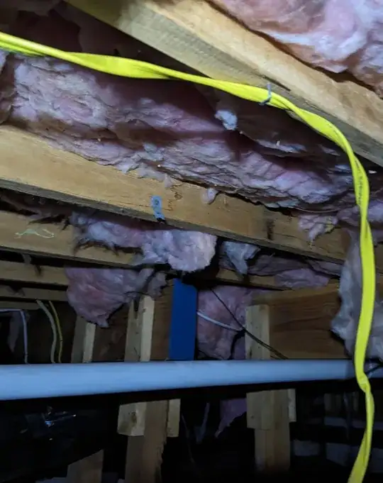

Yesterday I ran a new 100ft home-run of 12/3 Romex through the crawlspace of my house, and I noticed that my cable is not as neat as other runs that other electricians had installed.
In particular, the cable had lots of knots and kept twisting (vs other cables I saw which looked nice and flat). Many of the twists and knots appeared when I was pulling the new cable from the crawlspace (a friend was helping feed it from the wall in the house, straight from the roll of Romex from the store). I tried to straighten certain parts with my hands but it was hopeless.
(p.s. I didn't leave the cable dangling like this)
Why is this happening and how can I pull straighter cable in the future?

If you don't unreel the cable, it gets one twist for every loop on the roll. Which is what this looks like - just pulling it from the center of a roll, or off the end of a reel, without turning the roll or reel.
Putting spooled/reeled wire spools on an axle, or using a turntable/spinning jenny for coils of unspooled wire, or having an assistant at the feed end who bothers to turn the roll as the wire comes off would solve it.
To answer the question about the cable you already have:
Buy new cable, then hang it over a stairway railing with a weight at the bottom for a day or two. Don't put a literal ton of strain on the cable, but sufficient to pull it straight.
Granted, 100 ft is longer than most people's stairways (are you by chance a lighthouse operator? No? Worth a shot) but then you can double it over and have just a few kinks in it rather than kinks all over.
