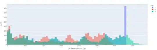

Using an arbitrary point in California I ran some simulations (using the default value for everything but the DC size and DC/AC ratio)
DC rating KW DC/AC ratio yearly AC kWh yearly DC kWh
4.5 1.366 7610 8015
3.63 1.1 6168 6466
4.5 1.1 7647 8015
The difference in effective annual AC production is 1442 kWhs for the panel upgrade. Had you also upgraded the inverters, you would have only realized an additional 37 kWhs.
That's just in the first year. Over time the panels will degrade such that your effective DC/AC ratio will get lower. Your current setup has cushion in the DC/AC ratio so effective degradation will be less pronounced than with a smaller DC/AC ratio (bigger inverters).
Additionally, inverter efficiency is maximized at high output. If you download the hourly csv file you can compare the dc and ac production. You'll see that the ratio of produced dc/ac is lowest when output is the highest:
The output_ratio is the DC power over the AC power for each hour of the aforementioned simulations color coded by the row of the above table. You can see how the red and blue dots follow the same curve because they have the same inverter size. The bigger inverter's curve is pushed out to the right so you can't get as much AC power when DC power is low.
Here's a histogram
You can see that with a high DC/AC ratio that row 1 (your actual setup) has a huge count at its inverter capacity. This is what you're seeing day to day. Intuition is telling you that if you had big inverters that you'd simply push that blue bar to the right and it'd be equal height. However, that's not the case. If you increase the inverter capacity, what this shows is that you don't move that tall bar to the right. You just kind of smoosh it down into marginally higher production that peters off pretty quickly to the right of where you are. This just reinforces the idea that having bigger inverters would only have gained about 37 kWhs/year.
