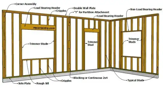

My 99% confidence approach is to simply find more studs. If you see the pattern, including any around doors and windows, you can be reasonably sure you have lumber and not pipes.
Once you do, cross-reference with baseboard nails, etc., and then drill slowly. You can tell a lot by feel once you get through the drywall.
