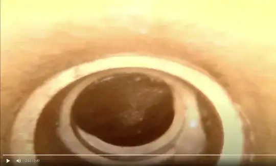

My bathtub drain seems to be clogged whenever I close and open the drain stopper. Plumbers snaked the drain but nothing comes out and the drain starts draining again.

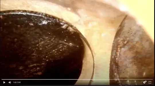

I put a camera through the overflow to take these pictures and found a disc like object covered with hair. What is this and how can I remove it ?

It looks like a coin. You can still see the engraving on the rim.
