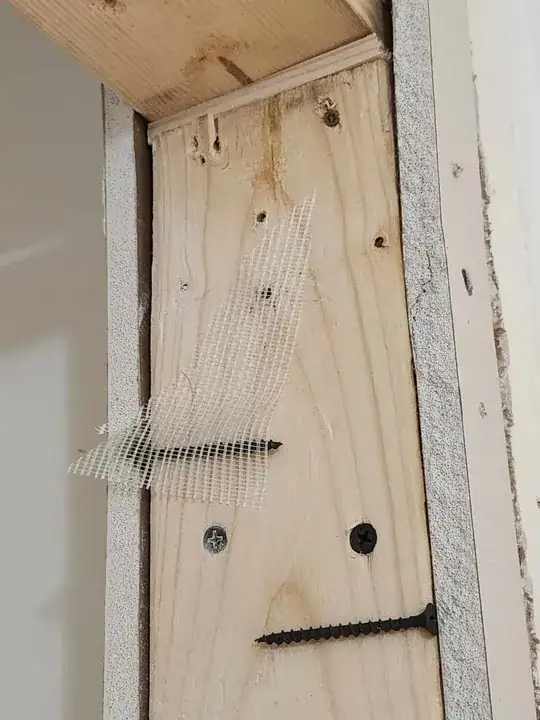

I've been reframing a closet door and have two studs that I've driven screws into and am now fastening sheets of drywall. I did this pretty haphazardly as a result of not having the correct tools initially and then gradually acquiring them.
So my question is, in the context of this picture, and for something that's non-load bearing, how should one think about woods' integrity in relation to having a bunch of screws driven through it often in close proximity and from multiple directions?
On a spectrum, from: A) I need to be very careful going forward and ensure I know where I'm driving screws, otherwise this piece of wood could spontaneously snap, or even that this piece of lumber has been irreparabley damaged and I should start anew
Or B) It's fine just sloppy but not a big dealenter image description here

Wood is usually quite forgiving to us idiots.
As long as you keep away from the edges and ends a piece of 2x4 can take more nails and screws than most peoples arms can drive in(nail guns are cheating).
Trying to drive 1/2 dia screws within a half inch of an edge might take a chunk of wood out of the 2x4 and you will end having to move the screw.
Pilot holes are very good near the ends and edges to prevent splitting.

Two basic rules
1- Always use screws made for the job/material, wood for wood
2- more importantly always pre-drill to avoid splitting the wood
How to choose pre-drill size. It has to have the diameter of the screw body (the inner part). Just choose a drill and holding it parallel (overlapping) to the screw so to see how it fits.
