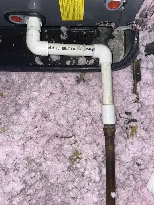

Picture of overflow pipe connected to the HVAC

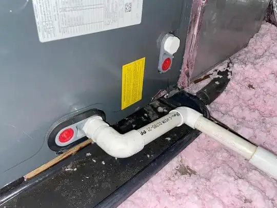

Picture of plastic overflow pipe connected to copper pipe
I can move the pipes up and down a few inches which causes the light grey plastic to move in and out a bit. I can't unscrew the pipe bolts as it feels like I'll break something.

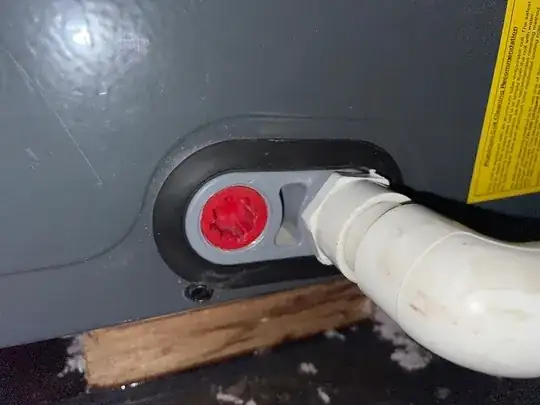

Close up of the fastener where the overflow connects to the HVAC system
Do I need to loosen this fastener? If so what is this type of fastener, or the tool I need called?

Those white PVC fittings are likely to be glued (and the piece that goes into your AC unit is likely threaded/screwed into place), so you're probably not going to be able to just easily disassemble the piping. I would guess that the red piece is a threaded insert that could be screwed out, but not sure that'll give you any good access to clean out the drain line. But in absence of being able to get into your AC unit and clean that drain line out from the inside out, you'll probably need to try and clean it out from the outside and hope it's not a long run of PVC pipe.
In absence of any other options, you may need to cut the white pipe in a good location and clean it out from both directions, then use a PVC union to connect the pieces back together to easily disassemble in the future, as if it has gunked up once, it's sure to gunk up again.

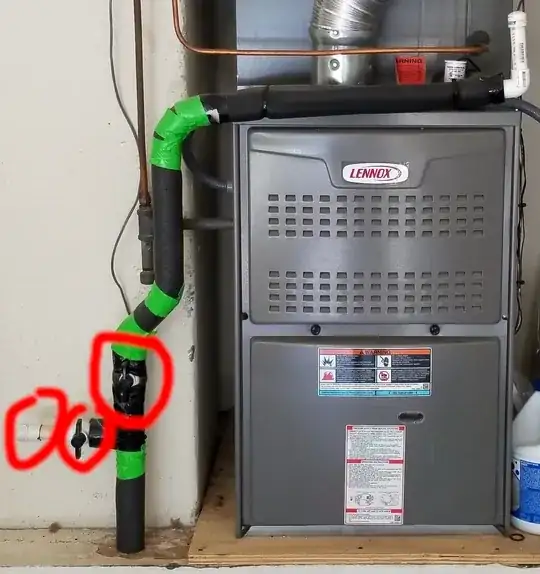

Typically the way to clean these out is to use a shop vac at the far end and suck the gunk out. Since you don't know where that goes, you can't do that. But that's also a problem. You really need to know where that goes.
If you can't or don't want to use a shop vac, you can use a garden hose instead if you plumb in 2 valves and a garden hose fitting. You just have to make sure you don't allow water to get in to your air handler.
In the picture below, you can see 2 valves and a garden hose fitting. Normally, the valve to the garden hose fitting is closed, and the other one is open. This allows the AC to drain.
To flush the line, connect a garden hose and turn it on. Then close the valve on the AC side, and open the valve on the garden hose side. Let it run for a few seconds, then close the garden hose side and open the AC side.

If the original installer was a good one, it's likely that some of the PVC fittings glued, but not all — for exactly this reason.
In your photos some are obviously glued and others are... well, hard to tell from a photo. It may be worth getting out the big pliers and checking for any that are friction-fit. PVC does tend to stick, though I have found silicone spray works well as "one-time lube" for getting plastic parts loose without worrying about long-term damage.
Edit: Of course if they are all glued you will need a saw, as other answers already suggest. A good opportunity to add a proper cleanout, since your install scenario is so obviously one likely to need cleaning. My experience has been with installs that have a condensate pump that will need to be replaced, so friction-fit makes more sense.

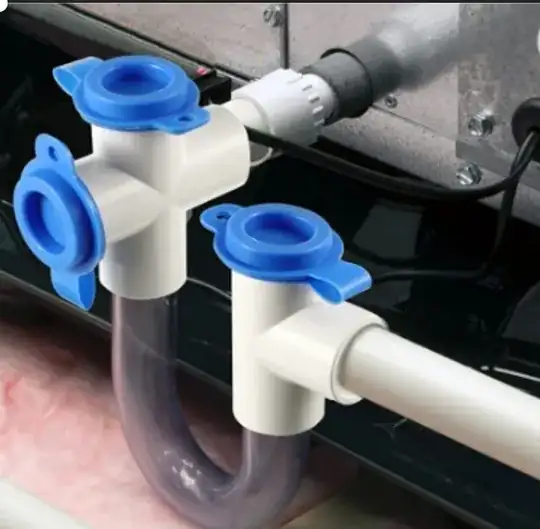

Your AC should have a condensate trap. This prevents suction of air into the blower through the drain which in turn improves drainage.
Some condensate traps include cleanout ports so you can use brushes and compressed air to clean the pipe.
Saw out and remove the whole PVC section and install one.
Here is an example. enter image description here
