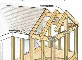

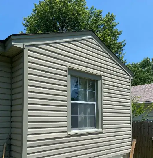

I will be expanding a master bedroom to add a ensuite bathroom. I will be using the existing window area to make it the entry door to the bathroom, see picture below. I always thought the best would be just extend the current gable roof over the addition, matching slope and dimensions.
After removing the siding my plan was to attach rafters on each side to the existing sheathing, support one end of the ridge beam that way, and just continue the same all the way to the other end (16ft long) (similar to Option A below).
At some point, someone mentioned that it would be easier to have the roof for the addition lower than the existing roof line (I don't really know why) like some construction have gable roofs (stepped or two layers). I hope I'm making sense with my explanation.
Any suggestions? Pros and cons? Something I'm not thinking about? Any feedback and suggestions is greatly appreciated. I'm in the Midwest US where wind is something to look for during spring. Not so much snow during winter. Using 2x6 for rafters and a non load-bearing ridge beam for the roof.

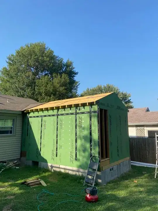

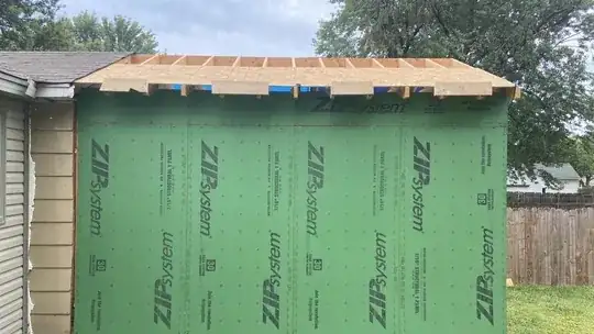

UPDATE Thank you everyone who posted an answer or comment, it really helped me figure out the best way in my current situation. I ended up removing all the siding until I got to the closest rafter to the edge. Then I just attached a new rafter on each side of the roof that will connect to ridge board for the extension. It worked just fine! I have to say the ridge board wasn't exact at the end (little lower and to the left of the current one in the main construction, but worked just fine! see pictures of the addition. Hope this helps anyone doing something like this!

When we did something similar we did option A. So it looked original. The builder removed the wood soffit and joined to the existing beams with no problem.
Option B is often used when there is a change in ground level and an internal step. You might have a change in internal ceiling height with option b or just less insulation.
It is, at the end of the day your choice.

Option B is really only possible when you'll change both the roof and the indoor ceiling heights. (Note the heights of the overhead doors in the photo: they indicate a change of indoor ceiling height in that building.) Thinking about proportions of the features I see in your photo, I'll estimate the existing room is 8 feet tall, window is 4 feet tall, and there's about 3 feet from floor to sill and 1 foot from window head to ceiling. In my view it's not viable to drop the level of the ceiling in the bathroom addition. The only way to do an Option B step in the roof would be to build the roof of the addition higher than the existing by building say 10 foot exterior walls or by using a raised heel truss.
Maybe it's a regional difference, but to my mind there's no such thing as a non-bearing ridge beam. I would use the term ridge board when roof and rafter weight is borne at the exterior walls and ridge beam when weight is carried both at the ridge and at the walls. The photo of Option A depicts a load bearing ridge beam, though I realize it's just a stock image and not necessarily representative of your intentions.
