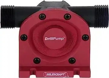

As mentioned, siphoning works. This is the simplest and it works, we have done it dozens of time. And it wont take weeks. Its cheap to sacrifice the end of the hose which you can chop off.
Siphoning will work, as long as tbe hose exit is lower than the bottom of the pool. Even if it isnt, you gould empty some of it.
For larger pools, we have used several hoses and even a drill pump like this. It attaches to your drill and is cheap to buy.
Or you could rent a small submersible pump.
