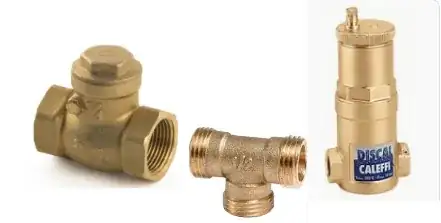

I have a string of brass components I need to connect together.
They all have corresponding Male/Female threads, so they all will go together, but is this a good idea?
It occurs to me that it will be difficult/impossible to tighten any of the fittings later without taking the whole lot to pieces?
Is there a 'typical' solution to this?

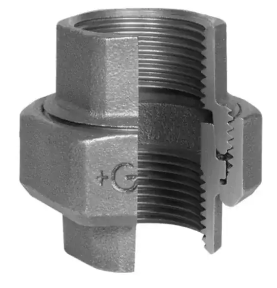

To facilitate an eventual future removal, you could put an pipe union fitting on each end of the assembly.
pipe union fitting
Martin
  • 3,084
So you put a joint or 2 in place so that it can come apart.
Similar to:
Form: https://www.hornbach.ch/fr/p/raccord-visse-a-joint-conique-en-fonte-malleable-georg-fischer-gf-n340-3-8-fi/10555916/
