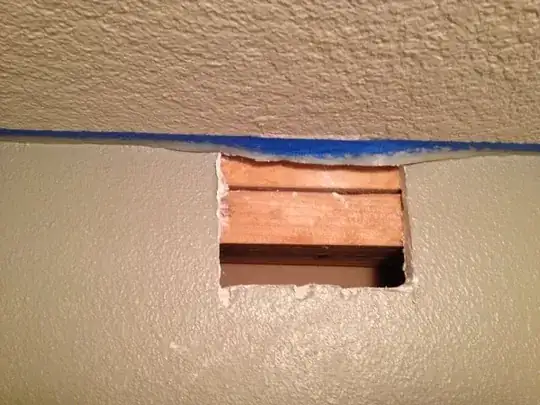

I'm considering removing a wall in my master bathroom but I can't tell if it is a load bearing wall or not. I've done a fair amount of research. I don't have the house blueprints, and it's difficult to get above this area in the attic. The house was built in 2007. The joists are East and West, parallel with this wall. I felt pretty confident removing this wall until I cut a small hole for further examination and found several stacked two by fours at the top. Is it common to do this on non load bearing walls or am I right to be concerned? Here is a picture for reference:

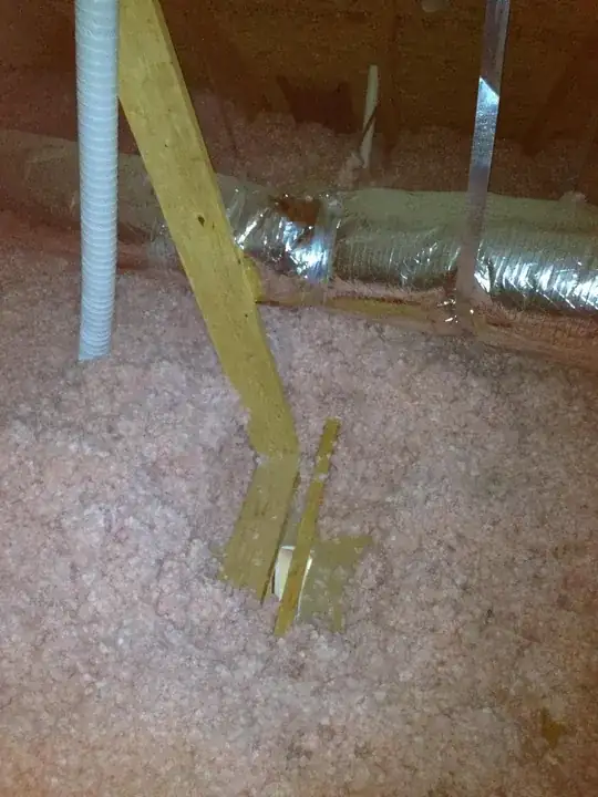

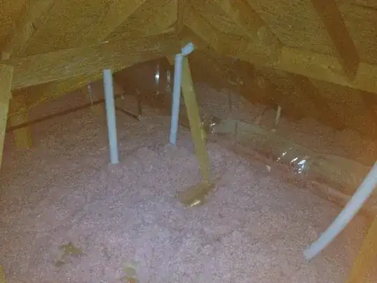

I removed some more drywall and checked in the attic. Here you can see there is a brace resting on a 2x6(?). I've never moved something like that before. Are there DIY options to continue with this project, or should I abandon hope?

OK normally load bearing walls will have 2 plates on top. But having 2 plates means nothing.
People frame however they learned to or want. Checking door header also means nothing. Some people flip all door headers - doesn't make the wall load bearing. You can never get into the head of the guy who framed your house. I worked for a construction company in college... the owner taught everyone to basically frame every wall like it was load bearing - 2 top plates and headers flipped was a minimum. I asked him one day why we were doing this and he basically said - Well it might cost an extra $10 on some walls but we never have to worry or redo anything.
You told me this wall goes in same direction as attic joists... That is a good sign. You need to get into the attic and see what it is attached to. If it isn't supporting a joist it isn't load bearing. If this wall is just floating between 2 joists - even with a few 2x4s for cross bracing - it is not load bearing.
However if there is structural bracing in the attic it is/could be load bearing. Or if it is directly under a joist.
You have two choices to figure this out. Get up in the attic or tear down enough drywall to figure out what you have. If you are a gambler and want this wall down just tear out the drywall - you will have to remove it to the joist on each side to redrywall anyway.
