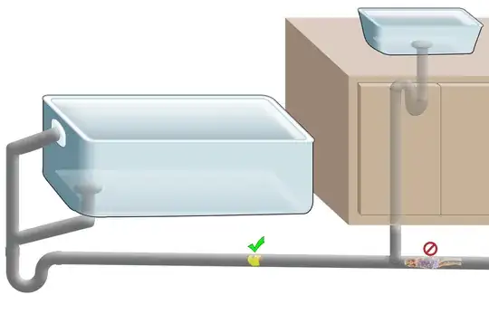

For future seekers of knowledge on this topic.. Pro Tip: You can learn a lot from the SOUND of your ShopVac. See, generally, your bathroom plumbing will look something like this:
Bathroom Plumbing
As such, the only clogs you're going to be able to get with a shop vac are those that lie BEFORE the drain pipe intersects with another - and that's assuming you block off the overflow valve (thats the one higher up on the bathtub).
Consider my doodlegram, here (we can presuppose your bathroom has better taste than my slapddash sketch). The rubber duckie is blocking your drain BEFORE the sink drain. As such, when you apply suction at the tub, there's nowhere else for the contents of the pipe TO go but to your vacuum. So... THOOMP!
But, after you've cleared the duckie, if that Barbie doll is ALSO stoppering you up and you apply that same suction, you'll simply start pulling air in from the sink. Your vacuum won't prove to be kenough.
That all having been said: if you apply the vacuum and once it has cleared out the water in the U-Bend, if it then starts to struggle (the sound it makes when you cover the hose with your hand), then you know A. the clog is nearby the drain, and B. sufficient vacuum force should clear it. If instead it sounds the same as it did BEFORE you applied it to the drain? Then you know it's either snaking or plumber time.

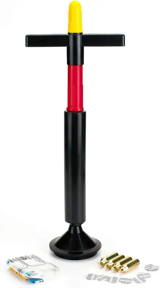

Prior to figuring out this method, I used the carbon dioxide cartridge method like this Kleer:
Kleer drain
but I found that was more "maybe" on getting it done compared to a shop vac that can keep pushing and pushing and pushing.
