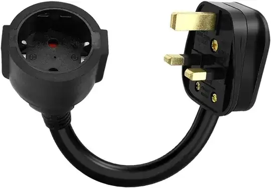

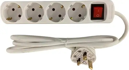

Assuming sending it back isn't an option, you would need to use a suitable adapter, which is rated for carrying the current the microwave would take. Most travel adapters are not rated for carrying many amps, but other extensions are: Plug extension (source: Amazon) 4 way extension (source: Amazon)
(by no means an endorsement of these specific products)
Another option is to buy a trailing socket of a suitable type (eg the 4-way Schuko lead shown here), cut off the plug, and attach a UK plug to it. This is often cheaper if you can pick one up when in a country that uses the Schuko plugs.
