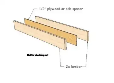

If you are using 2x4 wall studs then the wall thickness is 3.5in. 2x8 board is 1.5in thick. So you probably will have to sandwich two 2x8 boards with 1/2in plywood in between to make header the same thickness as the wall:
header from 2x lumber
