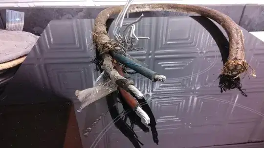

enter image description hereenter image description hereI have placed two induction surface units on top of our 30-year-old GE coil element stove (model JSP31GOP1WH). I have removed all four coil burners. Each of the induction units is rated at 1800 W at 120 V so each draws 15 A. The instructions for each unit states to plug into a 20 A circuit, but we have only one 20 A circuit available. Right now we have both connected to that circuit through a 20 A GFCI duplex receptacle. We only turn on one unit at a time.
Obviously I could install another 120 V 20 circuit, but I would like to get power through the heavy 4-wire aluminum cable (original 53 year-old 50 A GE breaker) that the stove appliance cord connects to through a NEMA 14-50 receptacle behind the stove.
My first thought is to connect a 12 or 10 AWG cable (3 + gnd) to the connection block on the back of the stove where the cord connects. I would route this behind the stove to a box surface mounted on the top back of the stove (magnetic hold fast?) or just resting there. This would be a multiwire branch circuit sharing a neutral or two separate neutrals wired to a 20 A duplex receptacle.
Another thought is to snake the 12 AWG cable through the back of the stove into the 3 inch high space under the stove top but I have pretty much rejected that.
The oven of the this stove still works and we are reluctant to buy a new induction range if this cheaper solution would work.
