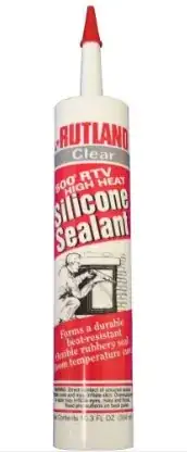

Edit: Per commenter's suggestion below, I came upon this product:

I would think you would go to an auto parts store and get a filler like Bondo .
Bondo has a pretty high heat rating and is not flammable in your conditions. You will sand the areas, use mesh for bigger holes and apply. You can't put this stuff on paint - it won't stick well. And I would make sure the bonding area is rust free too. This should be about a 2 hour job.
