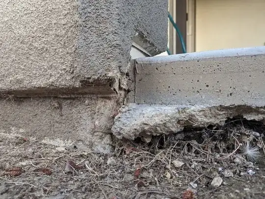

I have a conundrum. The concrete slab depth ends right around the stucco weep screed on one side of the patio. I want to install turf and obviously won't be able to make it flush. There may be less than one inch of space between the end of the slab and the weep screed.
If I install the turf right where the slab ends, the blade height will be up in the weep screed. What are some options I have?
My current game plan is filling the void and then installing turf below the weep screed and lastly installing a transition piece to cover the ugly side view of the slab/foam and also as a way to prevent trip hazards with the step. Any ideas on if such a transition piece?

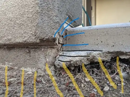

As shown in this pic enter image description here
Areas marked by blue need to be filled with a polyester caulk such as[Vulkem][2]
Then extra cement, as shown by the black lines, should be knocked off carefully. Drilling some holes and hitting with a concrete chisel should do it.
Then scrape back the dirt from the foundation at least 6 inches deep, so it can be painted below grade. A good 2 or 3 coats to seal the home.
With painting done, back fill grading the soil away from the house and slab. as shown in yellow.
When the house wall is painted and sealed you can place your sod. The plan should still be to have the base of the sod below the bottom of the wall.
