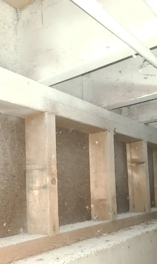

My deck is currently failing due to the fact that it is supported by 2x4 boards nailed into what is either a double plate below the floor joists or the end grain of the joists themselves, there is no band joist.
The deck joists are just sitting on those 2x4 boards.
I have put a stack of 4x4's beneath the deck to help support the load for now.
In the most affected spot, the deck is about 1.5 inches away from the house and 2 inches down.
The rest of the deck is supported with posts and concrete poured below frost depth.
I am thinking I have 2 options.
Option 1- cut back the siding and install a proper ledger board by putting in blocking and using DTT2Z brackets with threaded rod connecting house joists to deck joists. This would likely also mean cutting the joists a little bit to ensure a proper fit when the new ledger is in place.
Option 2- Make the deck free-standing. this would involve digging 48" holes for the frost footings and it is pretty tight under the deck so I would prefer option 1.
Does anybody have any wisdom to share about anything I should do differently?
Is this even the right way to go about this sort of thing?
Upper portion of second picture is where blocking and tension ties would be installed
this is in the crawl space where the blocking and tension ties would be installed
