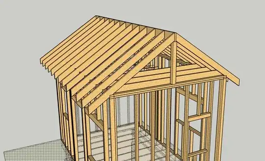

10'x16' insulated off grid "cabin" build. I want to use gable vents for my ventilation because it seems way simpler than a ride beam and soffit vents. I have a post centered on each 10" wall to support the ridge board.
  1. how would I install a centered gable vent around this post?
  2. what other framing do I need in these triangles on the gable ends above the top wall plate?
  3. if I want a foot overhang can I accomplish that by just overhanging my sheathing on the gable end or do I need to build a "ladder"?
I have my walls framed and stood up with some bracing. I am stuck overthinking and over researching roof venting, soffits, rafters, etc.

How would I install a centered gable vent around a ridge post?
Gable vents are little more than penetrations in the sheathing, and if you're using a commercial grille they pretty much just lay over the surface as a trim and pest prevention component. Wrap your post in something weatherproof and dark colored (so it isn't so conspicuous) and carry on.
FYI, a ridge board doesn't require posts. Its sole purpose is to make holding rafters in position a bit easier, and once the sheathing is on it's rather superfluous. However, a ridge beam would require posts, but it needs to be substantial enough to carry much of the roof's load. You may not need either if you have adequate rafter ties.
What other framing do I need in these triangles on the gable ends above the top wall plate?
Put studs in there at 16" or 24" centers to support your sheathing. You might only need two aside from the post. Once the gap height is below 24" you're good unless you want siding backing.
If I want a foot overhang can I accomplish that by just overhanging my sheathing?
Yes. 12" overhangs are adequately supported by the sheathing and by the fly rafters, which are in turn supported by the subfascia at the bottom of the slope.
