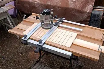

You can buy one of the many available adjustable router templates or make your own.
Retail Template Example
Adjustable Router Template
Shop-made Template Example
Homemade Template
Using Templates
There are lots of ways to use templates, like router bits with bearings, or you could use template bushings, or just push the baseplate against the template.
