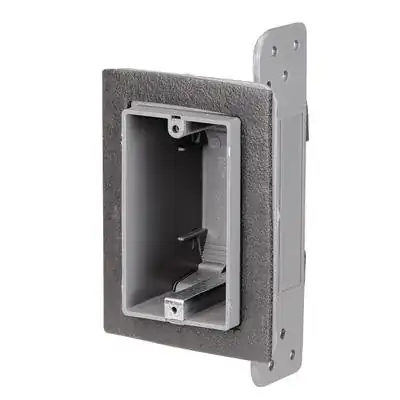

Typically for new construction, you'd use an insulated and sealed box:
The vapour barrier is sealed against the gasket when drywall goes up.

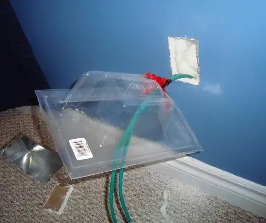

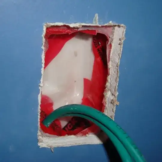

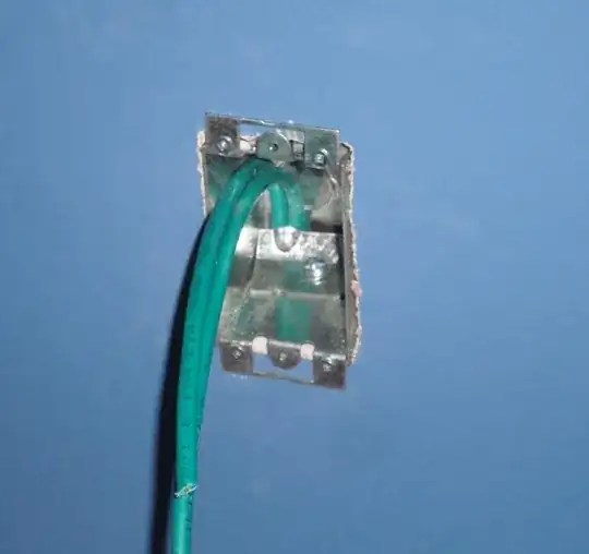

EDIT:
This worked brilliantly.
I cut a square hole out of the existing vapour barrier, then pushed the vapour box in behind it and spread it out. I then used tuck tape to attach from the back of the existing vapour barrier to the vapour box (using several small overlapping pieces), and had enough room to fit in a regular old work box.

I think you'll have to get one of these vapor barrier boxes, and fit it before installing your electrical box.
Seal up where the cable penetrates, then install your electrical box.
